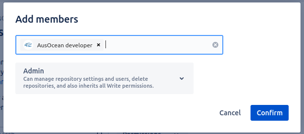

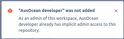

Thanks for your response! I tried clearing the cookies and cache and adding the admin via repository settings > user and group access > add members. Unfortunately I got an error message when trying to add them as admin saying that they already have admin access (although they aren't shown on the list.). Here's some images to help with this issue.

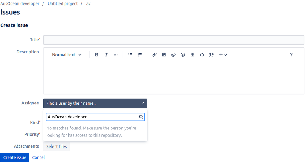

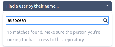

As you can see, I still can't even find the user to add them, despite being able to see all other teammates and external accounts suggested in the assignee field.

I did some internal refresh on that user. Could you please try again and let us know if it's now being shown in the suggestion list?
If it still not showing, I'd suggest logging in with the account you are trying to assign (AusOcean developer in this case) and leaving a comment on the issue, so this account gets prioritized in the suggestion list. You can then log in back into your account and try assigning the issue again.
