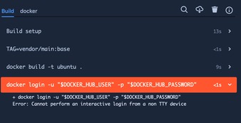

I get the following error message:
So I did the build step wrong. Perhaps you could look over this and tell me what I did wrong?

That now builds correctly from the repository's Dockerfile. However, the "docker login" bit is where it now catches. I get a `Cannot perform an interactive login from a non TTY device` Error. How do I run this bit non-interactively?

Hmm, the error message first made me thought "funny, I didn't had that issue yesterday". Thinking twice I have the following idea what is going on:
  • login with username and password is tried
  • it fails
  • login on TTY (interactive terminal) is tried which must fail in pipelines as it is automated and asking for the user to enter the password will lead nowhere.
Double check the login works by verifying username and password in the environment variables (have you set them up on Bitbucket? I forgot to mention that requirement specifically as I thought it's known, but that perhaps was shortsighted. let me know if you need more details regarding environment variables on Bitbucket Pipelines).
