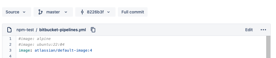

Are you referring to the Edit option when viewing a file on Bitbucket Cloud website? This option should be visible at the top right corner of a file, please see the screenshot below for reference:
Please keep in mind that if you select an older hash from the commit hash dropdown, the option will be disabled.
Is this the Edit option you are referring to? If so, can you post a screenshot to show us what it looks like for you?

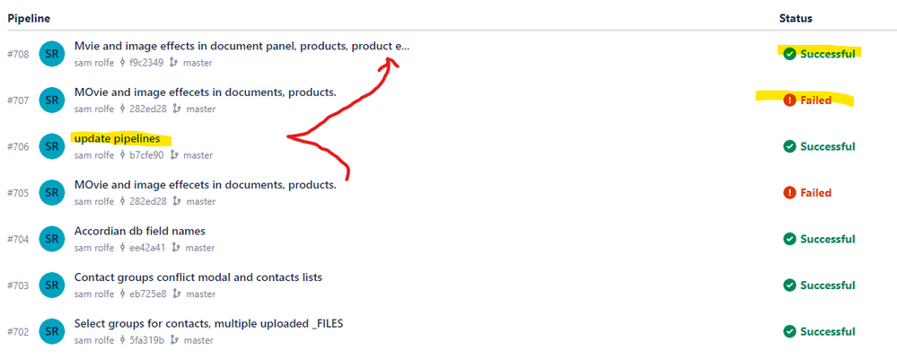

As it stands I use Eclipse which pushes to Bitbucket which deploys to many sites.
So my local version is up to date as it has successfully pushed to Bitbucket - however bitbucket has NOT deployed do to an "error" in the pipeline.
As mentioned - all this is as expected.
However I am now left with an orphaned deployment that can not be fixed.
The only solution I have is to use a list of previously pushed files in my local, edit everyone of those files locally and push them again with the new yml file already added.
Here is a screen grab.

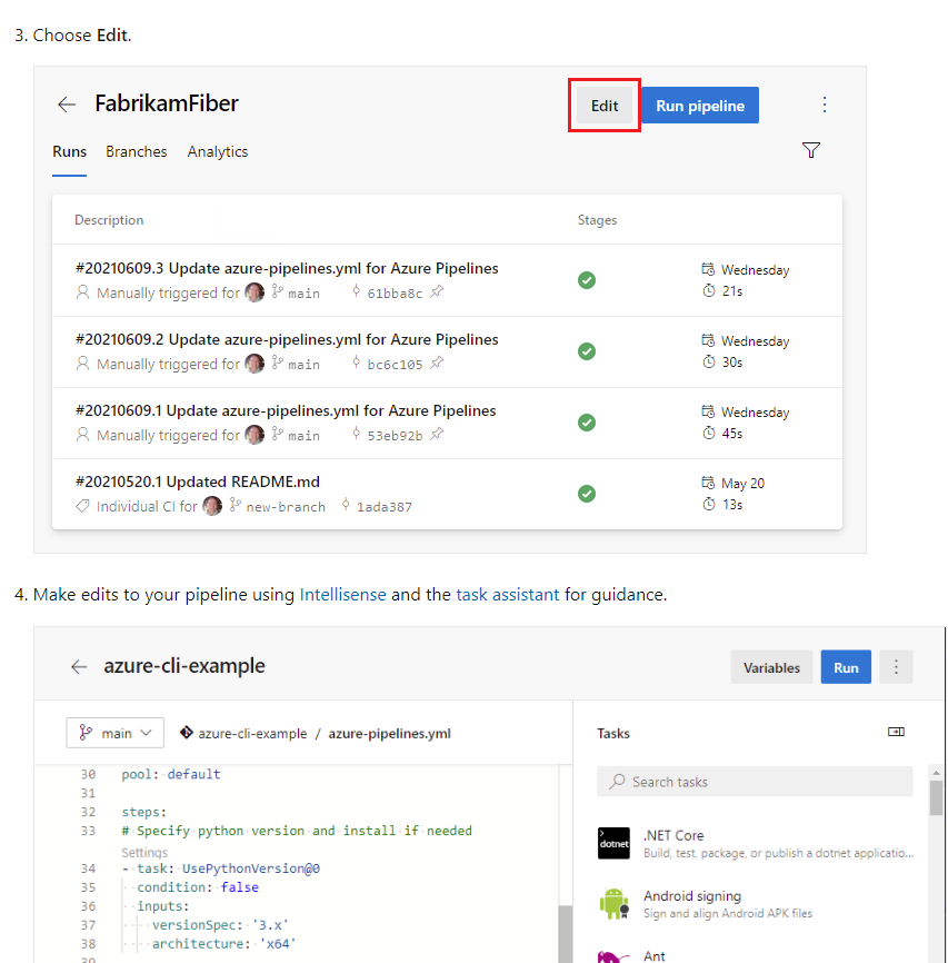

Here is AZURE pipeline editor editing the buildfile for re-deployment.
This is what I was hoping was available, or something similar, some way of editing the buildfile on a pipeline so that I can just re-run it with the fixes in place.
