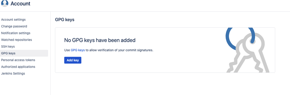

I've read the instructions for creating an app password but i don't see the options in my account settings.
"see the screenshot below "

Your screenshot looks like it's from a Bitbucket Server account (in a self-hosted instance). I think I misunderstood your previous comment ("I am using a Company Instance of Bitbucket..."), I thought you meant it was a Cloud instance with a domain claimed by your company.
Just to make things clear, your company is using Bitbucket Server (self-hosted instance, on your own servers) instead of Bitbucket Cloud (hosted in https://bitbucket.org/), is that correct?
If so, then this is indeed the culprit. The two products have differences and they also have a different API. The API endpoint we've been talking about concerns Bitbucket Cloud only.
