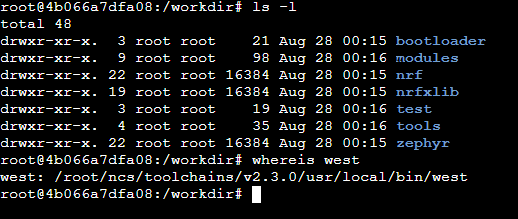

If you run this image locally, you can find something like this:
However, when this image is launched using Bitbucket pipeline, you will find other "WORKDIR", you do not find any of that folders described above nor "west" tool installed

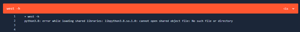

I think that thre is something more, I tried your recommendation but there is other error:
This pipeline was working with previous versions of nrf-docker, but not with the last changes.
They also have some issue with Github actions. Therefore, I do not know if it is happening here the same.

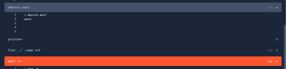

Since you described that running it locally the west command was found, I tried running it locally following the below sequence of commands and encountered the same issue :
$ docker pull nordicplayground/nrfconnect-sdk:v2.3-branch
$ docker run -it --entrypoint=/bin/sh nordicplayground/nrfconnect-sdk:v2.3-branch
# whereis west
west:
Could you please try running the above commands and let us know if you have a different output? Kindly share the full output with us here. Make sure to run the docker pull first, as this will make docker download the latest version of the image with that tag, as you might have an older version cached in your local machine.
