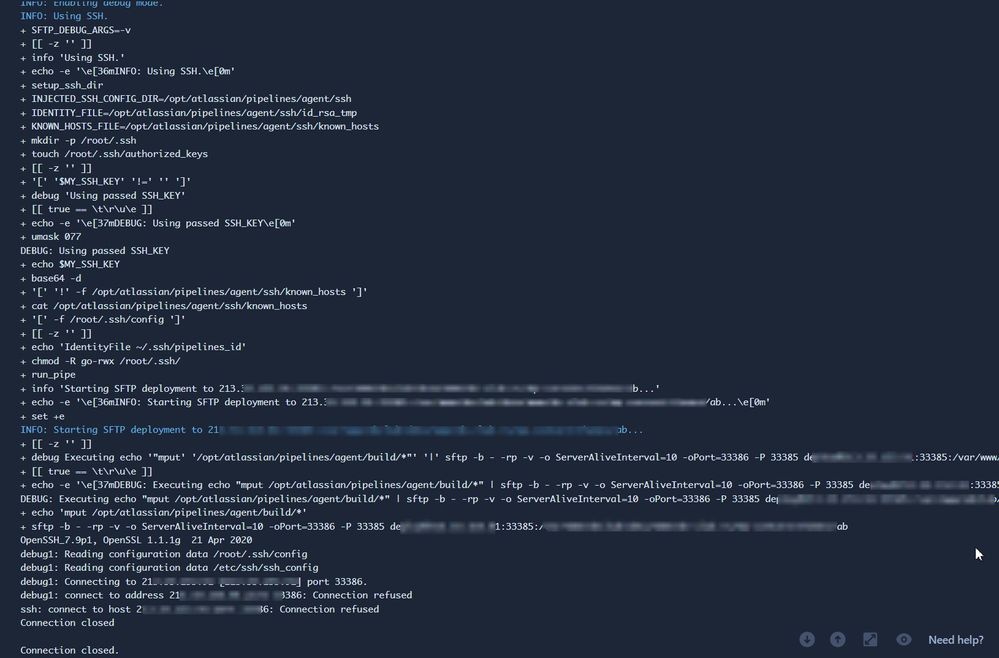

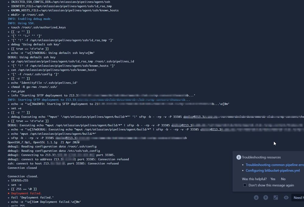

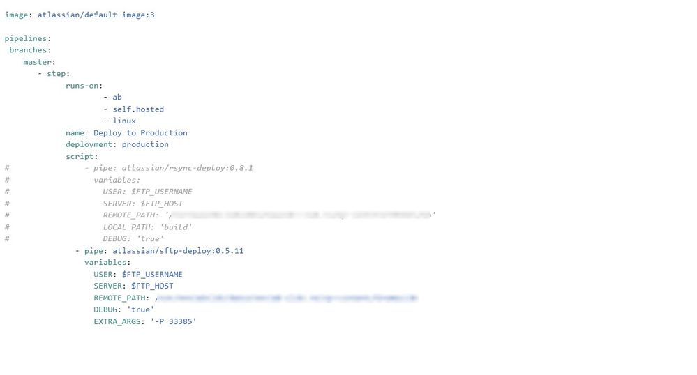

Hi! I have a problem, I can't understand why there is no connection. Please have any ideas? from other sources, I connect to my host without any problems. and this problem is also with rsync deploy

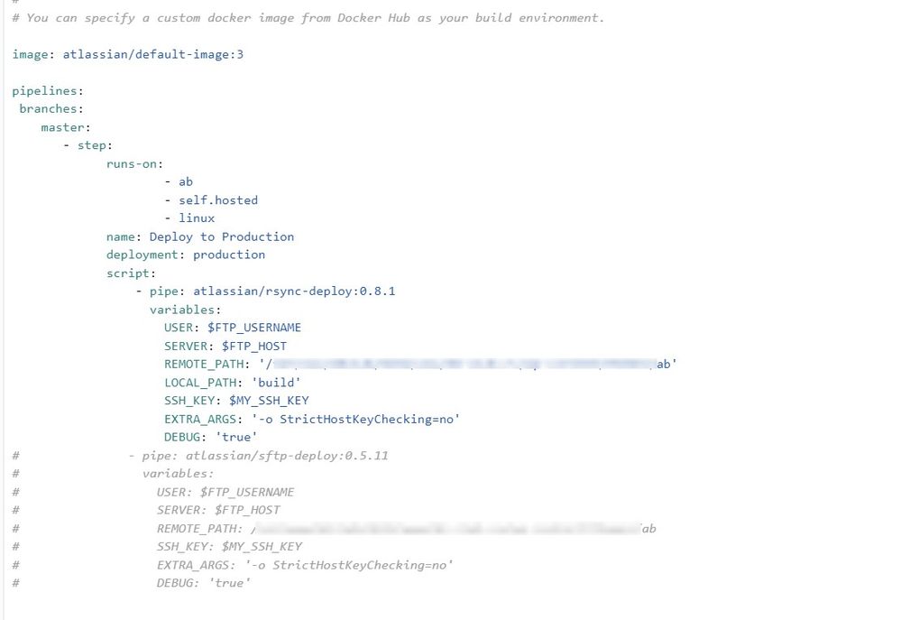

Hi
For this case you need to pass SSH_KEY directly to the pipe
SSH_KEY An alternate SSH_KEY to use instead of the key configured in the Bitbucket Pipelines admin screens (which is used by default). This should be encoded as per the instructions given in the docs for using multiple ssh keys
script:
  - pipe: atlassian/sftp-deploy:0.5.11
    variables:
      USER: 'ec2-user'
      SERVER: '127.0.0.1'
      REMOTE_PATH: '/var/www/build/'
      LOCAL_PATH: 'build'
      SSH_KEY: $MY_SSH_KEY
      DEBUG: 'true'
script:
  - pipe: atlassian/rsync-deploy:0.8.1
    variables:
      USER: 'ec2-user'
      SERVER: '127.0.0.1'
      LOCAL_PATH: 'build'
      DEBUG: 'true'

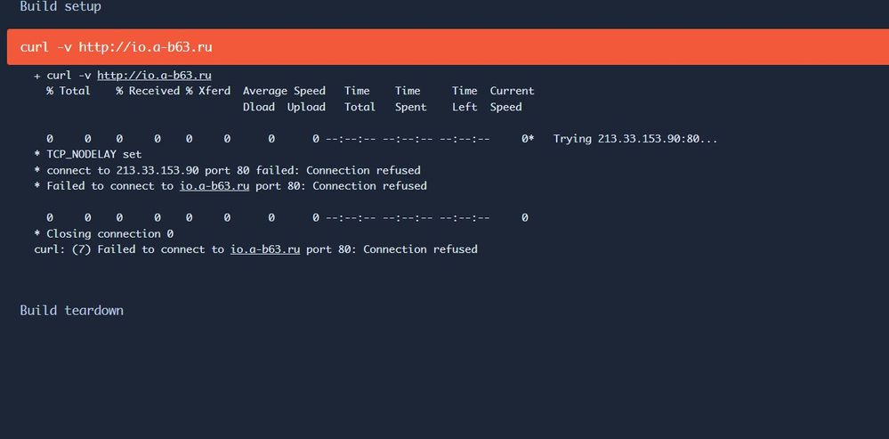

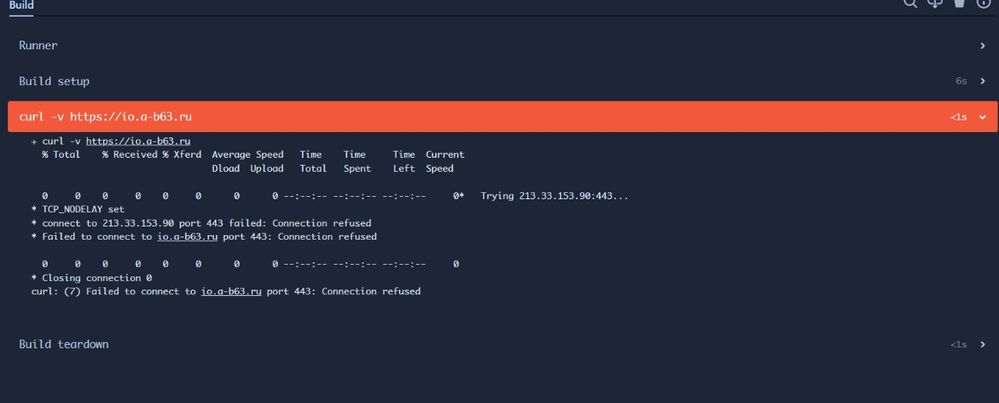

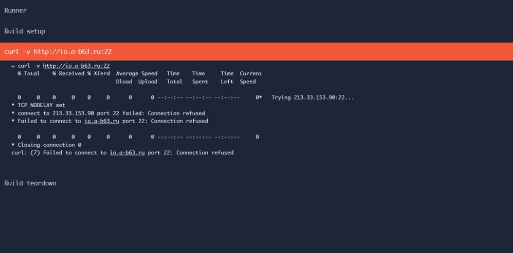

Hi! my problem is relevant. I'm not getting anywhere. I did curl, in all cases it was refused. Maybe you have blocked IP addresses and therefore my connections are being reset.photo1677484072 (2).jpegphoto1677484072 (1).jpegphoto1677484072.jpeg

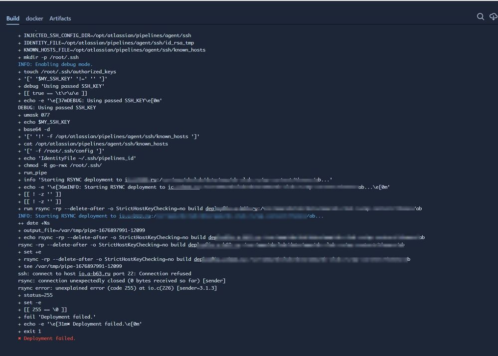

February 20, 2023
I don't understand what I'm doing wrong. Please help mersync1.jpgrsync12.jpg

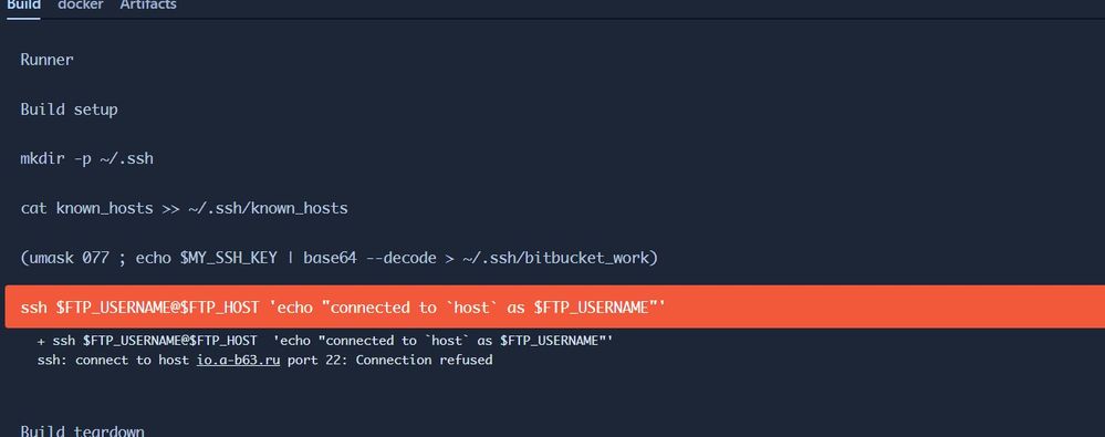

Oleksandr Kyrdan
February 20, 2023
Make sure you encode your SSH_KEY accordingly:
Linux
base64 -w 0 < my_ssh_key
Mac OS X
base64 < my_ssh_key
and copy/paste the value without trailing symbols.
To validate base64 encoded SSH_KEY, try to decode it and use for the direct connection on your local machine.

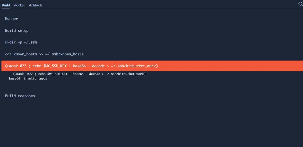

Админ
February 21, 2023

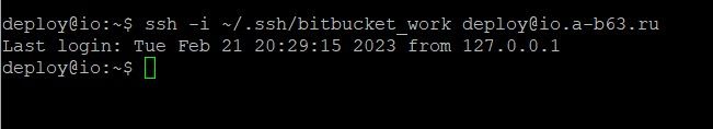

Thank you for helping me. I added the key and tested it, if the key is incorrect, the log informs me, but with the correct connection it is refused. The local host connects without problemscorrect.jpgincorrect.jpglocal.jpg
