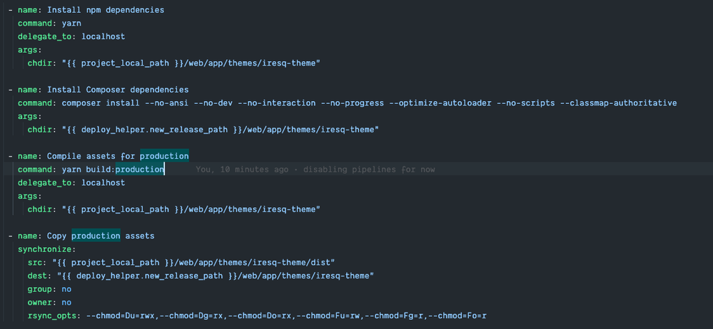

I have a new Wordpress build on Kinsta using Trellis/Bedrock/Sage by the Roots team. Trellis comes with a command to deploy directly from your local version but I'd like to automate this. Where i'm getting stuck is with the build-before.yml file that is ran with deployment. Here's what it looks like:

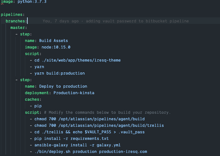

As you can see these commands require installs such as Node, PHP, and rsync. But the main Trellis command that will be ran to deploy my code in the pipeline requires the python image. So the issue started just by running this pipeline and Bitbucket wasn't able to go through the commands in the build-before.yml file because it only had the python image defined. Here's a look at what my current bitbucket-pipelines.yml looks like and then I'll get into what I think I need to do from here and what I've tried so far
So I think what I need to do is get rid of the scripts in build-before.yml and split them up into separate steps in my pipeline config. In the image above you can see that I already added in the Build Assets step that will get rid of the Install NPM dependencies Compile Assets for production steps in the build-before.yml file.
I ran the pipeline after deleting those steps from the build-before file and my assets were built successfully. But now I'm getting stuck on the Install Composer Dependencies Copy Production assets steps.
