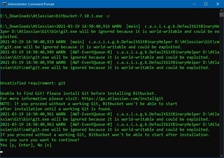

On trying to install Bitbucket 7.10.1 next, wasted about a day yesterday trying to diagnose the error "Unable to find Git! Please install Git before installing Bitbucket".  That is the error presented by the GUI when I attempt the install by double click on the installer.  I did a lot of research, Git is there, installed properly, is on the path, machine rebooted, etc.  That is not the problem.
Running out of ideas, I decided to run the installer from the command line and surprise, surprise, see pic below.  The installer is actually finding the git.exe program, in two places, but it is ignoring it because "it is world-writable and could be exploited".  Really???  Why not present that little fact on the GUI error message?

I got this problem. Using chmod didn't resolve it. I had to edit permissions on the git installation folder to disable inheritance and add full access to SYSTEM and Administrators only. After that, it worked.

After working on the problem for days, I found the solution myself.  The solution was to remove access rights from the Git cmd and bin folders.
Again, the Bitbucket installer is not presenting the correct feedback to the user when it fails in this situation.  I did not find any information regarding the actual problem of the git.exe being ignored, and of course no recommendations to resolve that issue.

Re: ERROR "it is world-writable and could be exploited"
I confirmed the findings of Carlos.
I removed the window USERS group from the BIN and CMD folders, (sub-folders of GIT) and the install proceeds sucessfully.
