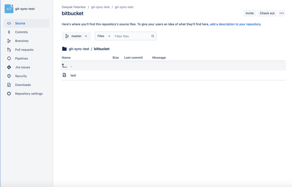

I am trying to fetch all the files from my directory. The curl which I am using is
curl -u "deepakpatankar:xxxx" -X 'GET' 'https://api.bitbucket.org/2.0/repositories/deepakpatankar/git-sync-test/src/master/bitbucket?page=1&pagelen=10'
But this request fails with the error

I read the documentation at https://developer.atlassian.com/cloud/bitbucket/rest/api-group-source/#api-repositories-workspace-repo-slug-src-commit-path-get and the above curl looks correct to me. Can you please have a look and suggest why the API failed.
PS:
I tried the API to get the content of a file and it worked. The curl of that API is very similar to the one having the issue
curl -u "deepakpatankar:xxxx" -X 'GET' 'https://api.bitbucket.org/2.0/repositories/deepakpatankar/git-sync-test/src/master/bitbucket/test?page=1&pagelen=10'
Screenshot 2021-12-30 at 4.09.49 PM.pngScreenshot 2021-12-30 at 4.09.57 PM.png
