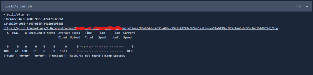

This creates an url like this, but I constantly receive an error.
% Total    % Received % Xferd  Average Speed   Time    Time     Time  Current
Dload Upload Total Spent Left Speed
0 0 0 0 0 0 0 0 --:--:-- --:--:-- --:--:-- 0
100 61 100 61 0 0 1033 0 --:--:-- --:--:-- --:--:-- 1033
{"type": "error", "error": {"message": "Resource not found"}}
I am pretty sure that these are the correct details to access the logs, I would appreciate any help. ❤️

The reason why the API call to get the logs is failing is because the step is only completed after the Build teardown, which runs at the very end on each step. Before that, the logs will not be available in our backend and thus cannot be fetched from the API.
My suggestion in this case would be to output the logs of the commands you are executing in the step to a file by using the tee command :
command |& tee -a output.txt
The |& tee -a command will make both the standard output and standard error streams to be copied to the file while still being visible in the UI. If the file already exists, the new data will get appended to the end of the file.
