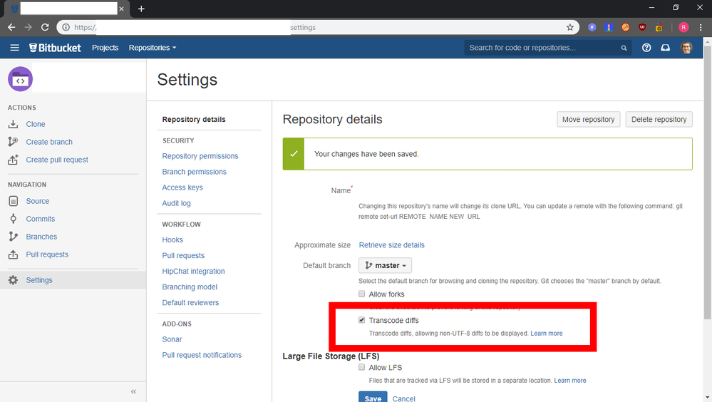

I was able to resolve the issue by checking "Transcode Diffs". This resolved the issue with comparing sql files.
@ryanvgates Thanks! Your answer is the correct one. No one can go around and remove BOM from the existing files.
