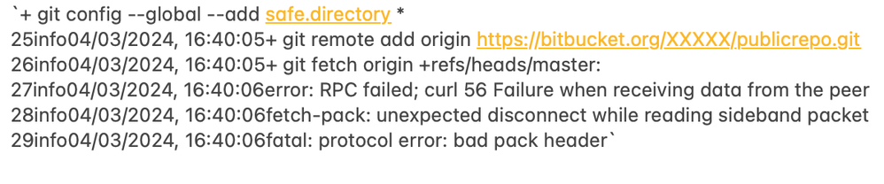

Vikas Haritwal March 13, 2024
Hey Theodora, Thanks for Ack here.
- We are using `Bitbucket Cloud` for this but account is different ( Official details can't share here)
- We are trying to access bitbucket public repo from VM Windows OSScreenshot 2024-03-13 at 1.52.06 PM.png

1. You mentioned that you randomly see this error. Does this mean that the git fetch command sometimes succeeds and sometimes fails on the same virtual machine?
2. What version of Git are you using on this VM? I've similar errors (although not exactly the same) with an older version of Git for Windows (version 2.39 specifically).
3. Is the error reproducible if you perform the same operation on a different machine on a different network?
The logs show that the error comes just 1 second after the git fetch command gets executed, so it's possible that something on the VM may be blocking the connection (e.g. firewall, antivirus) or it could be a network-related issue.

Vikas Haritwal March 17, 2024
Hey Theodora,
Thanks for response, Please find below details as requested:
  1.  Yes we are getting it randomly
  2.  git version 2.44.0_window
  3. Yes we tried with 2 diff network, able to reproduce same on another network as well.
Currently we are using VM GCP, may be we can try same with AWS VM and verify it once.

Theodora Boudale
March 18, 2024
Hi Vikas,
Thank you for the info.
I found that there is a bug that occurs when cloning Bitbucket Cloud repos with Git 2.44.0.windows. We have an open bug report here:
Could you please try one of the workarounds mentioned in this bug report?
You could either change the http.sslBackend in your Git config with a command as follows:
git config --global http.sslBackend openssl
Or, in case this doesn't work, you can uninstall Git 2.44.0.windows and then install the earlier version, 2.43.0.
