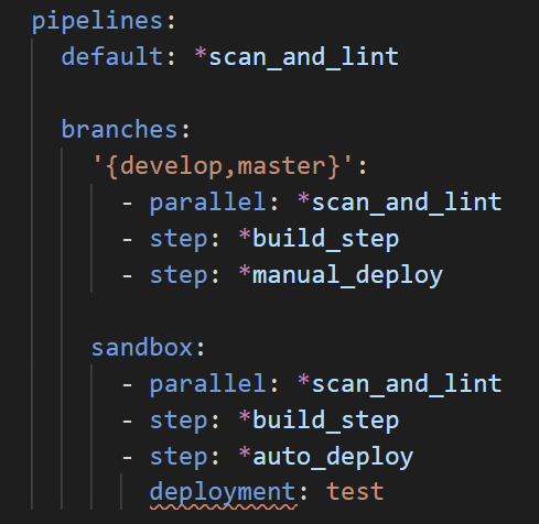

Yes, you are right, the manual and auto-deploy have only one difference - manual or auto-trigger for deployment. And yes, we are deploying to the different environments and we would like to have several "deployment" scopes with the variables but needs to reuse the yml steps. But as you can see on a screenshot we can not utilize "deployment" flag.

Thank you. I did in the same way, but faced the problem of adding Deployment flag with variable to the steps. So in the current situation i have two choices 1) Mess in global pipeline variables but readable yml 2) Mess and lot or repeats in yml but split variables for each `deployment`.
