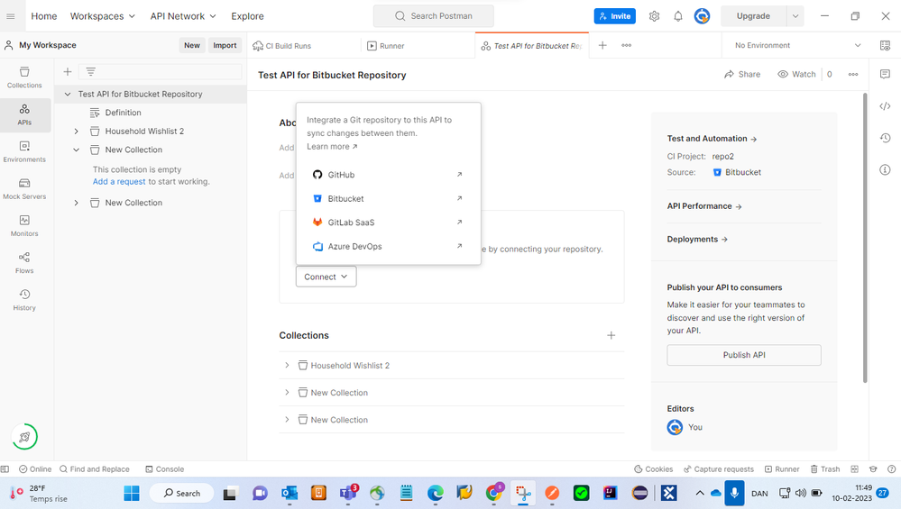

Q1. Could you please share a screenshot of where exactly in postman you are connecting to the remote repository in Bitbucket?
Q2. Is the end goal of your integration to have your Postman API collections pushed to a bitbucket repository as defined in Postman - Integration Bitbucket ?
Yes, its first part of my goal

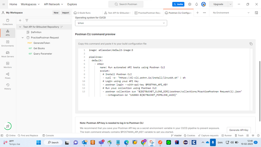

Finally, I want to execute a pipeline in Bitbucket and run the postman collection(API) in the pipeline.
So far,
1. I have connected the Postman - API to bitbucket repository

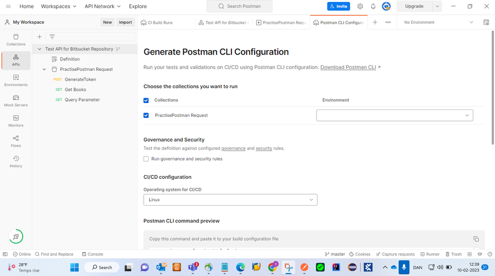

2. and further to a bitbucket pipeline , using Postman CLI configuration;
screenshots attached
2.1 I have added the API key from Postman to the Bitbucket as a parameter
Postman CLI configuration part 1 for postman.pngPostman CLI configuration part 2 for postman.png
