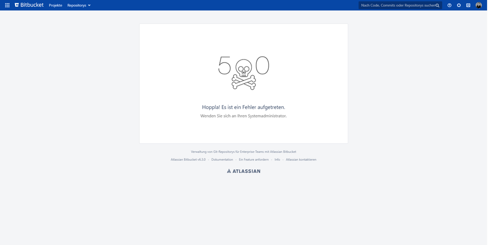

When I create a new repository it shows me error 500.
The Bitbucket runs on the atlassian docker image and is a brand new setup with no customization other than the mysql-drivers. The project was also empty and has just been created.
Thanks for the help!

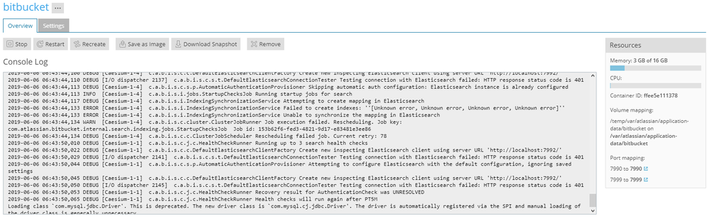

I run the docker container through plesk and mapped the home directory to /temp/var/....  I inserted both the jdbc 5 and 8 drivers on both I get the error 500 each time I recreated the container and deleted the database, so effectively it was a clean install every time. I updated my git from 2.17 to 2.21 and it still appears. As far as I could narrow it down it happens with MySQL and some data related to the repo can't be written/read in the database. I also did a rollback to the previous bitbucket version (6.3.0).

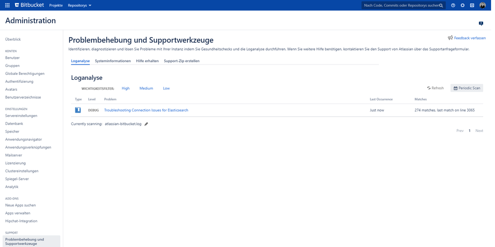

I enabled the debugging and profiling and accessed my repo again now in the support section I got one hit and it links to elasticsearch not being accessible.
here is my docker overview with the message also
https://confluence.atlassian.com/bitbucketserverkb/troubleshooting-connection-issues-for-elasticsearch-826900037.html?utm_medium=logScan&utm_source=STP

Hello Patrick,
Thank you for looking at and review the logs. While these errors are helpful for the elastic search, this won’t cause the 500 response you’re getting when creating a repo. If we did confirm permissions for the path are configured correctly then it would most likely be a database or connectivity issue that is causing your error. I would like to focus now on the MySQL configuration and JDBC file to ensure we’re correctly setup. Could you please review the Bitbucket MYSQL setup found at Connecting Bitbucket Server to MySQL and ensure the following is correct:
  • MySQL version supported under Supported platforms
  • The database was created with the correct collation and the character set.
  • The correct version of the JDBC is used.
Additionally, please check the log scanner and report any findings to us so we may see additional causes to the failure. Here is how to access and use the log scanner: Log Scanner and Scheduled Log Scanner.
