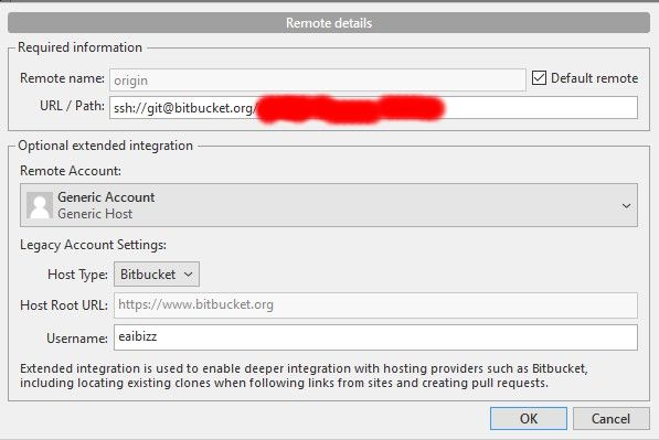

In the specific repository which goes wrong, I do see 2 origins ("origin" and "composer") with the data mentioned in the image below (below the quote).
So I don't see any reference to my colleagues login details.
I even checked the config file in the .git folder, but I don't see any credentials there either.

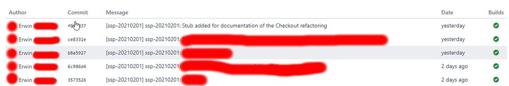

Here are my commits:

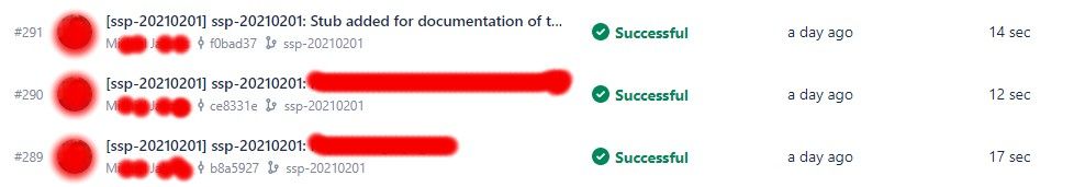

And here are some of the pipelines which were triggered by those commits:
You can see that MJ is mentioned here, while I have made the commit.

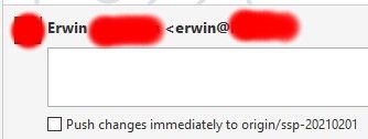

Can I be authenticated differently in SourceTree for committing and pushing?

The author of a commit and authentication are two different things.
The author is determined by what email you specify in your local Git configuration and it doesn't have anything to do with authentication. For example, if you use in your local Git configuration an email that is not associated with your Bitbucket Cloud account, then this commit will not be mapped to your user in the Commits page of the repo in Bitbucket UI.
When you push to a repo, we don't look at the author of the commits (you can push commits with author other than your user). You get authenticated either by HTTPS (Bitbucket username + password) or SSH (with SSH keys you have set up for your Bitbucket Cloud account), so we can check if your Bitbucket user has permissions to push to this specific repo.

- I see in the screenshot of SourceTree remote details that the repo has an SSH URL.
We can double check if the SSH keys used in SourceTree are indeed linked to your Bitbucket account.
