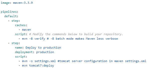

I found under following link that I can create settings.xml file in the root of my project and push it to bitbucket repo and then use:
- mvn -s settings.xml
But it didnt work for me and failed with error:
No goals have been specified for this build. You must specify a valid lifecycle phase or a goal in the format <plugin-prefix>:<goal> or <plugin-group-id>:<plugin-artifact-id>[:<plugin-version>]:<goal>. Available lifecycle phases are: validate, initialize, generate-sources, etc...
