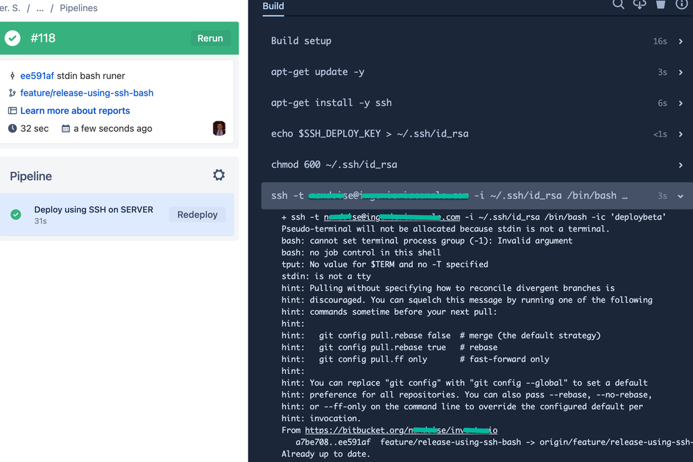

Fernando Sarmiento
February 16, 2022
!WORKS Like charm
image: php:5.6-apache
pipelines:
default:
- step:
script:
- apt-get update -y
- apt-get install -y ssh
- echo $SSH_DEPLOY_KEY > ~/.ssh/id_rsa
- chmod 600 ~/.ssh/id_rsa
- ssh -t <user>@<domain.com> -i ~/.ssh/id_rsa /bin/bash -ic 'bash_alias'
bash_alias file content
#!/bin/bash
cd www/test
git pull
 Evidence
