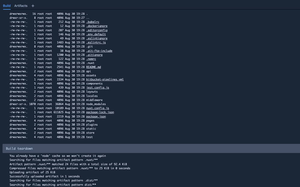

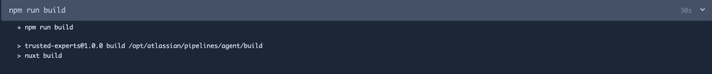

I added the debug option to my .yml file. The strange thing in general is that in the build step the .nuxt directory builded. But the /dist directory in root is still missing or ignored.
Screenshot:
npm run build (no error and no warning is thrown in build step)
but ls -la is shown that there is no build created to upload to server:

+ npm run build
> trusted-experts@1.0.0 build /opt/atlassian/pipelines/agent/build
> nuxt build

+ echo "$(ls -la)"
total 760
drwxrwxrwx. 16 root root 4096 Aug 30 19:28 .
drwxr-xr-x. 8 root root 4096 Aug 30 19:27 ..
-rw-rw-rw-. 1 root root 212 Aug 30 19:28 .babelrc
-rw-rw-rw-. 1 root root 12 Aug 30 19:28 .dockerignore
-rw-rw-rw-. 1 root root 207 Aug 30 19:28 .editorconfig
-rw-rw-rw-. 1 root root 146 Aug 30 19:28 .env.default
-rw-rw-rw-. 1 root root 49 Aug 30 19:28 .eslintignore
-rw-rw-rw-. 1 root root 1483 Aug 30 19:28 .eslintrc.js
drwxrwxrwx. 8 root root 4096 Aug 30 19:28 .git
-rw-rw-rw-. 1 root root 38 Aug 30 19:28 .git-ftp-include
-rw-rw-rw-. 1 root root 1200 Aug 30 19:28 .gitignore
-rw-rw-rw-. 1 root root 122 Aug 30 19:28 .npmrc
drwxrwxrwx. 5 root root 4096 Aug 30 19:28 .nuxt
-rw-rw-rw-. 1 root root 2541 Aug 30 19:28 README.md
drwxrwxrwx. 2 root root 4096 Aug 30 19:28 api
drwxrwxrwx. 4 root root 4096 Aug 30 19:28 assets
-rw-rw-rw-. 1 root root 1534 Aug 30 19:28 bitbucket-pipelines.yml
drwxrwxrwx. 5 root root 4096 Aug 30 19:28 components
-rw-rw-rw-. 1 root root 439 Aug 30 19:28 jest.config.js
drwxrwxrwx. 2 root root 4096 Aug 30 19:28 layouts
drwxrwxrwx. 2 root root 4096 Aug 30 19:28 locales
drwxrwxrwx. 2 root root 4096 Aug 30 19:28 middleware
drwxr-xr-x. 1070 root root 36864 Aug 30 19:28 node_modules
-rw-rw-rw-. 1 root root 10189 Aug 30 19:28 nuxt.config.js
-rw-rw-rw-. 1 root root 611825 Aug 30 19:28 package-lock.json
-rw-rw-rw-. 1 root root 2219 Aug 30 19:28 package.json
drwxrwxrwx. 4 root root 4096 Aug 30 19:28 pages
drwxrwxrwx. 2 root root 4096 Aug 30 19:28 plugins
drwxrwxrwx. 4 root root 4096 Aug 30 19:28 static
drwxrwxrwx. 2 root root 4096 Aug 30 19:28 store
drwxrwxrwx. 4 root root 4096 Aug 30 19:28 test
+ ls -la
total 760
You already have a 'node' cache so we won't create it again
Searching for files matching artifact pattern .nuxt/**
Artifact pattern .nuxt/** matched 24 files with a total size of 92.4 KiB
Compressed files matching artifact pattern .nuxt/** to 25 KiB in 0 seconds
Uploading artifact of 25 KiB
Successfully uploaded artifact in 1 seconds
Searching for files matching artifact pattern .dist/**
Searching for files matching artifact pattern dist/**
Searching for test report files in directories named [test-results, failsafe-reports, test-reports, surefire-reports] down to a depth of 4
Finished scanning for test reports. Found 0 test report files.
Merged test suites, total number tests is 0, with 0 failures and 0 errors.
It looks like the /dist directory is not being generated at all. It looks specific to your project configuration and there are number reasons this may happen. Does it work when you run the same set of commands in your local environment and when you try to run it in Docker?
