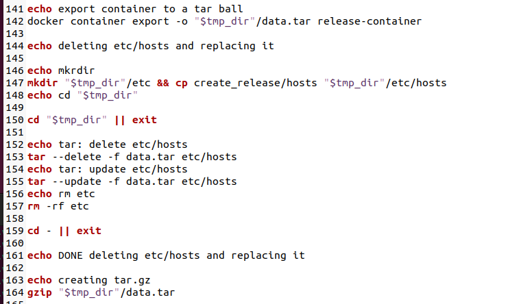

I am creating a .tar file base on a docker container and need to update one file (/etc/hosts). Therefore I am running the following commands:
tar --delete -f data.tar etc/hoststar --update -f data.tar etc/hosts

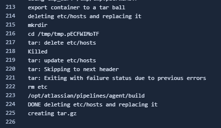

The output I get from the pipeline is the following (and this results in am unfinished tar file):
What could be the issue here?
Here you can see a more detailed screenshots of the steps undertaken:

In the tar --delete command you provide as argument the file etc/hosts. Is the path of the file correct?
Is your last screenshot from a script that you are executing during a PIpelines build? Can you add the command set -x at the beginning of this script, then run another build and see if that gives additional info about the error?

The screenshot shows the part of a script that concerns the tar file. The tar is created by exporting a docker container, then doing modifications to the tar file and finally, compressing it with gzip.
After set -x I can see that the commands I expect are run but no additional output to give more information on why killed is printed is shown.

thank you for your reply. Using the commands provided in (1) I was able to figure out that the memory used by tar --delete is more than the runners have. Unfortunately also the 2x runners run out of memory. This is the reason why I did not early notice that this is the issue.
Unfortunately for now I do not have a real solution to this issue yet.
