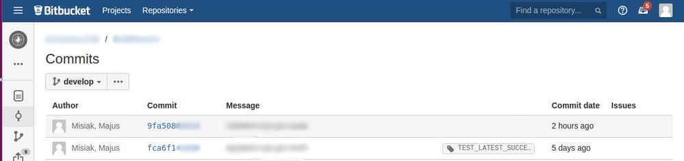

But surprisingly the tag was still visible in the GUI
even though it did not exist in git at all! After this, I could overwrite this tag in GUI by making another post request, resulting in new tag and changed tag in GUI.
To the contrary, if I tried to overwrite this tag, before actually deleting it with a request, I got 409 (Confict) response, as could be expected. I got the same behaviour with python requests and curl, i.e. the tag could be successfully deleted from git, but it would remain visible in gui.
This is very baffling for me.
Moreover, only way I have found to delete this hanging tag, was to actually make new tag for the same commit using git CLI:
git tag -a TEST_LATEST_SUCCESSFUL fca6f1
git push --tags
and then explicitly delete it:
git push origin --delete TEST_LATEST_SUCCESSFUL
after that the tag dissappeared from GUI.
