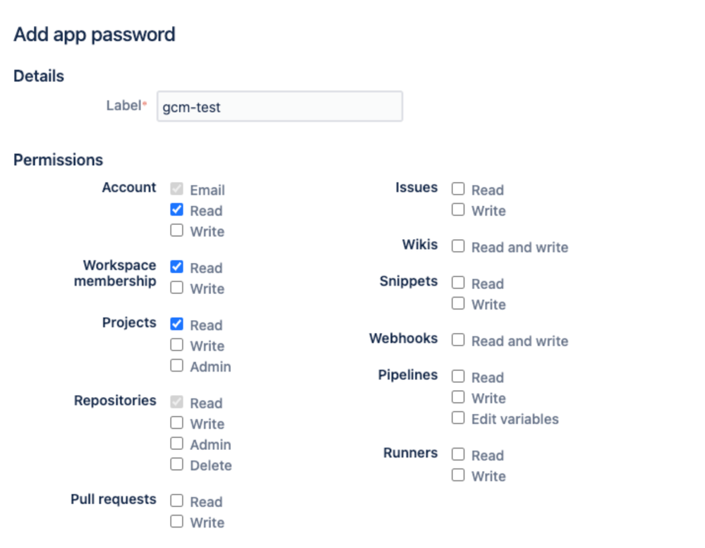

Also, it's important to note that according to GCM's documentation related to Bitbucket Authentication :
If you are planning to use an App Password for basic authentication, it must at a minimum have Account Read permissions (as shown below). If your App Password does not have these permissions, you will be re-prompted for credentials on every interaction with the server.
So could you please confirm if the app password you are using contains at least the scopes shown in the image?
Let us know in case you have any questions.
