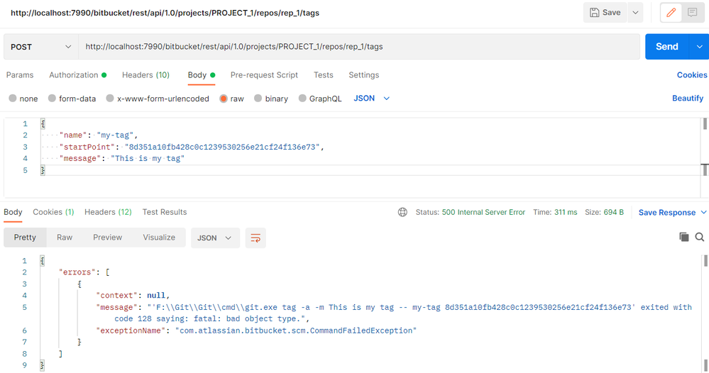

孟行
July 21, 2021

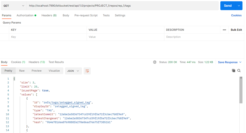

Hello,I was following the API docs https://docs.atlassian.com/bitbucket-server/rest/6.10.0/bitbucket-rest.html?_ga=2.33858657.1166200213.1595259633-444055661.1594387875#idp347 to create tag.
I was able to fetch tags by using GET in postman
But when I try to do POST, I get 500 Internal Server Error
I was confused
