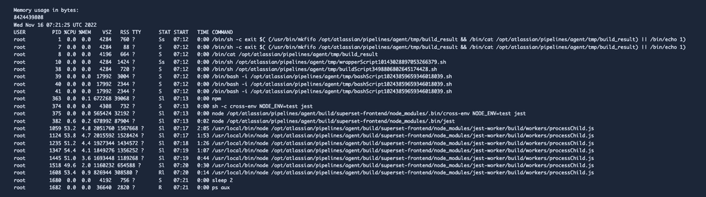

Hi @Syahrul
We implemented it and the pipeline again fails with the following memory consumption just before the pipeline termination
In order to deal with this issue, we onboarded a custom Linux with Docker runner, and the pipeline runs successfully.
Docker stats show the build container memory utilisation of ~2.5 GBs at maximum.
Our preference would be to make it run in our existing setup without using the overhead of a custom runner, any assistance in this regard from your side will be appreciated.

Syahrul
November 16, 2022
Hey @Muhammad Usman Khawar
G'day.
In the ps aux output screenshot, VSZ is the Virtual Set Size, a memory size assigned to a process during the initial execution.
The Virtual Set Size memory is simply a number of how much memory a process has available for its execution. While RSS is the memory currently used by a process. This is an actual number in kilobytes of how much RAM the current process uses.
The screenshot shows that the multiple node processes have VSZ = 2051760 KB, equal to 2 GB in binary.
The total amount of each process uses more than 8 GB of memory where the allocated memory of 7GB hence your build hit the memory exceed the limit.
The 2x option gives you 8GB of memory in the build, but 1 GB is used as reserved, so you are left with 7GB memory usage only. Your build currently uses more memory than it is allocated hence it's failing with memory exceed error.
The workaround is to limit the memory usage of your process using --max-old-space-size below the 7GB limit or reduce the amount of node process to run in a time from 7 to less than 4.
I hope this helps.
