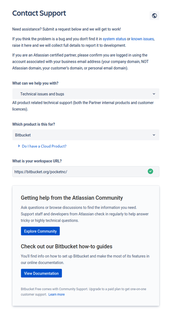

I went through the remediation link and ran through the process. The files are no longer shown in the repo (I only have the single branch).
The docs say, contact support to explicitly run GC on my repo. I tried contacting support but the contact option is greyed out and I'm apparently only limited to community answers.
This is despite the fact that this is likely a systems problem that requires intervention from an administrator.
This is admittedly my fault, but this entire process has been extremely frustrating since there is no self-help option but I'm not special enough to have a person pay attention to me.

Hi @Sam Koepnick and welcome to the Community!  You ARE special enough to have people pay attention to you.  Have you tried contacting Support here:  https://support.atlassian.com/contact/#/
Sam Koepnick
December 21, 2023
I appreciate the validation!
Unfortunately, I need to convince the helpdesk system of the same. And I'm genuinely hoping that I've missed something simple and I can give a hearty facepalm emoji.
I've tried that link before. But after filling out the details, the rest of the form implies that I only have access to community support.
I've hunted all over the page for a hidden submit button or whatnot.
