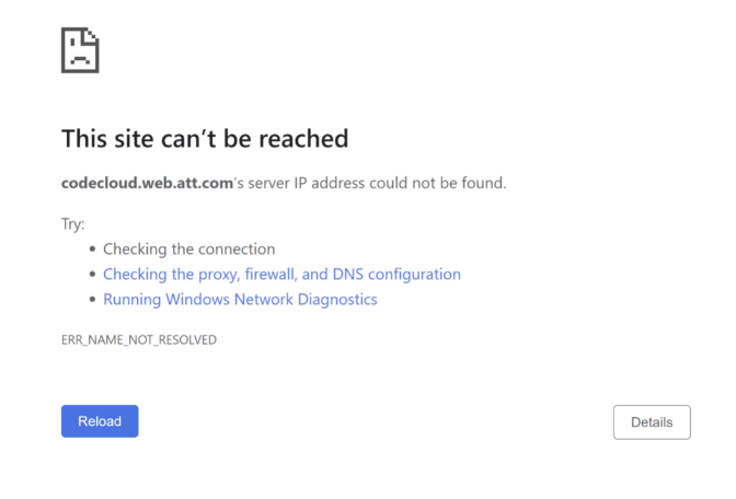

We are trying to create a service connection for bit bucket from Azure Devops but receiving following error.
Unauthorized request. Bitbucket returned the error: 'VS30063: You are not authorized to access https://api.bitbucket.org.'
My URL is not accessible over the internet.
Need bitbuckets team help to understand what settings can be changed to make it accessible (API access/non-Interactive)
My URL is :  "https://codecloud.web.att.com/projects/"

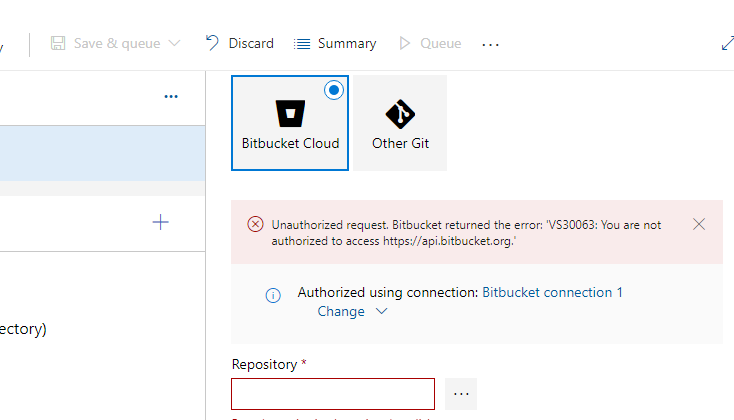

We tried with both the options which you have shared.
1.OAuth:
When we are using the OAuth, it asking the @ email id. But we are using Mechid to login into the codecloud it doesn't have the domain name. We tried creating the service connection with Mechid and password getting below error.

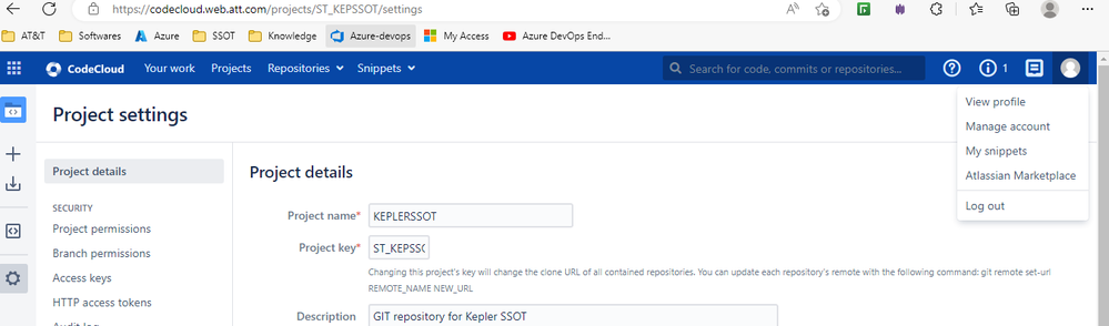

2.Basic Authentication:
In Basic Authentication method, I am unable to create the APP Password.  Not able to figure out the option to create the app password in my bitbucket UI as per the instructions shared on App Password Hyperlink.
Please find the attached screenshots for the same. And let me know if any other way to fix this issue.
OAuth Issue:
App_Password unable to create, Not finding the given options in my UI.

Syahrul
April 4, 2023
G'day @sai
It appears that you are using Bitbucket Server instead of Bitbucket Cloud, so the suggestions I previously provided may not be applicable since they are intended for the cloud version only.
As I am not an expert in Bitbucket Server, I may not be able to assist you much further. However, I did find some documentation that may help you with configuring your Bitbucket Server with Azure.
