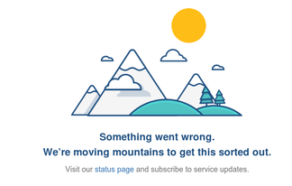

I upgraded to JIRA 7.5.0 and Bitbucket to 5.4. I tried to find a document explaining more thorough how to configure Bitbucket's server.properties.
There were some general, superficial explanations. Now I tried to get some more thorough explanations but all I get is:
When I go to Bitbucket settings and look at the application link the both way communication shows me that the OAuth(Imper) is working normally, but when I go to Jira settings I see a OAuth invalid signature.
Now please send me a thorough parameter explanation of the server.properties configuration so we can fix this and continue to work normally, since we are trying to fix this for the past day.

Hi Daniel,
Hopefully you're able to access our resources again. There is a good document on the properties for Bitbucket titled Bitbucket Server config properties.
The first thing I would do is remove the Application Link and re-create it per the Application Links Troubleshooting Guide. Breaking the link does not lose any data so you won't have to worry about that.
We have a knowledge base article titled OAuth error oauth_problem=signature_invalid that may be of use. Just in case you're unable to view the Confluence page here is the important information from that article:

Hopefully that helps provide clues on where to look and any changes you need to make.
Note: In times where I was unable to access Confluence, I used the cached link to access the page until it came back up:
Alternatively I have also used the Wayback Machine to find articles that are archived.
