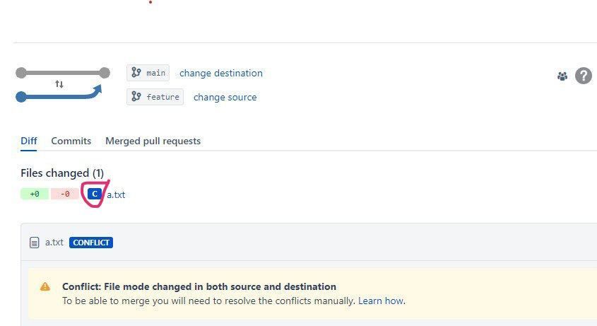

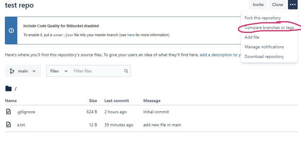

There is a feature as "Compare branches or tags" which I am using to compare the branches for any merge conflict(screenshot attached). Now I want to do this via the bitbucket REST api. I tried searching to docs but was unable to find the endpoint. Can somebody please help with this?

Thanks @Theodora Boudale  for the answer, it works. Now I can see the "status": "merge conflict" in the response. However, I have a doubt.
I just went through the diffstat API documentation and found out about the "topic" parameter. By default, when I don't include this parameter (as shown in the example above), I only get diffstats of type "merge conflict" (which is exactly what I'm looking for). However, if I set it to false or true, I get a lot more diffstats, and they don't seem to include diffstats of type "merge conflict".
Omitting the topic parameter altogether works for me, but I wanted to be aware of what is actually happening. Can you please help me with this confusion?
