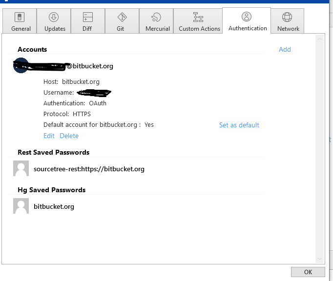

chauhan01
January 13, 2020
I face same issue and the finally found the solution.
under Tools -> Options -> Authentication.
You have to open the Authentication option ( under Tools -> Options -> Authentication.) and then click on Edit.
After arriving on edit screen. Click on Refresh OAuth Token.
And finally the refresh token is assigned and issue will be fixed

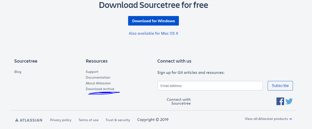

Ganiyu Sodiq Olaniyi
December 20, 2019
sourcetree ganiyu sodiq.PNGI solved this problem by installing a previous version. You can get all the versions when you scroll to the bottom of sourcetreeapp homepage.

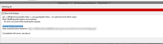

this dont works for me:
fatal: HttpRequestException encountered.
An error occurred while sending the request.
remote: Invalid username or password
