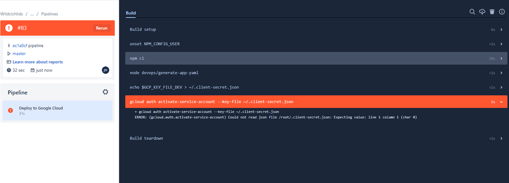

I'm trying to setup the pipeline to automatically deploy a nodejs application to Google App Engine. I've set the GCP_KEY_FILE_DEV variable in the repository > Deployment > Environment "Development". The variable contains a base64 encoding of the service account file needed to authenticate. But, I keep getting the same error. See screenshot. Any ideas? Thanks.

Hi Igor
Thank you for your reply. I've tested and validated the base64 encoding. But, it still produces the same error. I've re-checked the permissions on the service account key file and that should be ok.
Any other ideas?
So, for tests you sent request from your console with your base64 encoded file and without using pipe and you received ok response?
Or you received an error even when trying to connect to Google Cloud App Engine from your console?
Seems i misunderstood you. I thought problem related to pipe.
Did you use this pipe: https://bitbucket.org/atlassian/google-app-engine-deploy/src/master/ ?
If not maybe you should try?
And for your case i think you should do something like this in your pipeline:
echo $GCP_KEY_FILE_DEV | base64 -d > ~/.client-secret.json
gcloud auth activate-service-account --key-file ~/.client-secret.json
