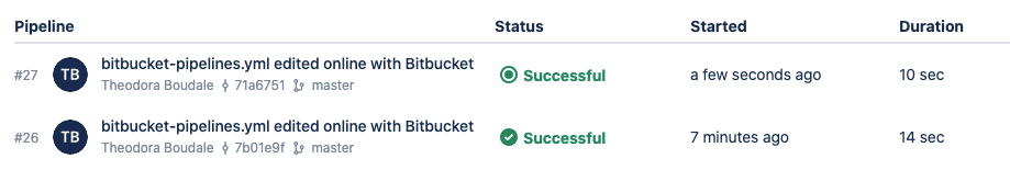

If you take a look at the following screenshot from one of my repos:
For Pipeline #27, the icon with a circle within a circle next to the status "Successful", indicates that there are steps that haven't run yet.
For Pipeline #26, the check icon inside the circle indicates that all steps have run.
Can you monitor it this way? Or are you looking for a way to programmatically retrieve this info?

Stefan Balan
December 8, 2020
Hi @Theodora Boudale
I was looking to programmatically retrieve this info in my YAML file and change it with a string data, depending on the step I'm in.
Your answer is a start, and much appreciated.
Best Regards Stefan
