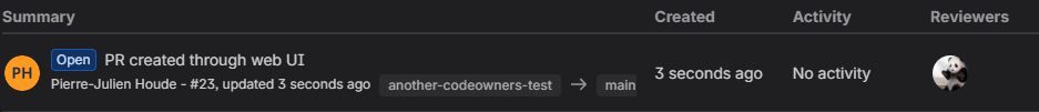

Yes, I confirm that this is the observed behavior, see screenshots below.
Edit: This is two PR created from the exact same branch, targeting the same ref for main. The first one has been created through the API and doesn't have the specified reviewer, the second one is from the web UI and the reviewers was automatically added like it's supposed to.
