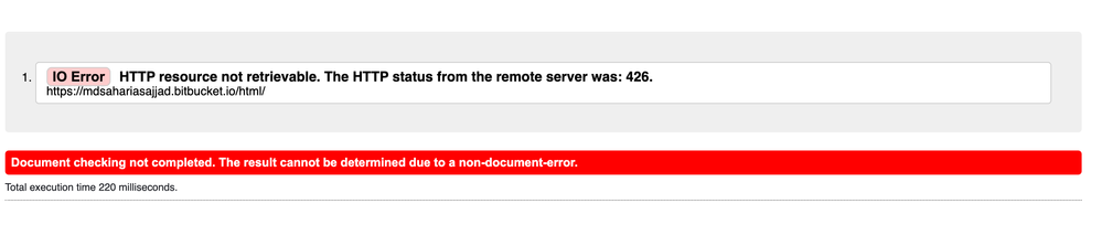

I think the httpd version on the server is behind. We are using bitbucket in class, and the w3c validator process comes back with
eg try  (I cannot paste!!???!) https://budyari.bitbucket.io.

I have 60 students, most with same problem
The error message does not relate to browser, it is w3c validator access to the URL on bitbucket.io
https://validator.w3.org/
Works on github.io

From the HTTP status code returned (HTTP 426), the server (bitbucket.io) is refusing the connection because the client (w3.org validator) is using an old/unsupported protocol.
In this case, I would suggest reporting this to w3.org, as they have a Report issue link available on the website. They will have more logs and details on what protocol upgrade is necessary on their side to allow the connection with bitbucket.io.

Ah thank you, have done, error message not helpful!
