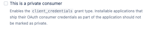

In our OAuth Consumer configuration page we state this. Screenshot 2023-07-03 at 12.51.20 pm.png
We state that shipping the consumer credentials with the app should only occur on a public consumer, and to me it's clear that if you're shipping credentials in your app, it's not a secret. But maybe this needs to be reworded to be clearer.
As this isn't a bug, more of an implementation quirk, we're unlikely to change our backend implementation to remove the need for a secret for public consumers.
