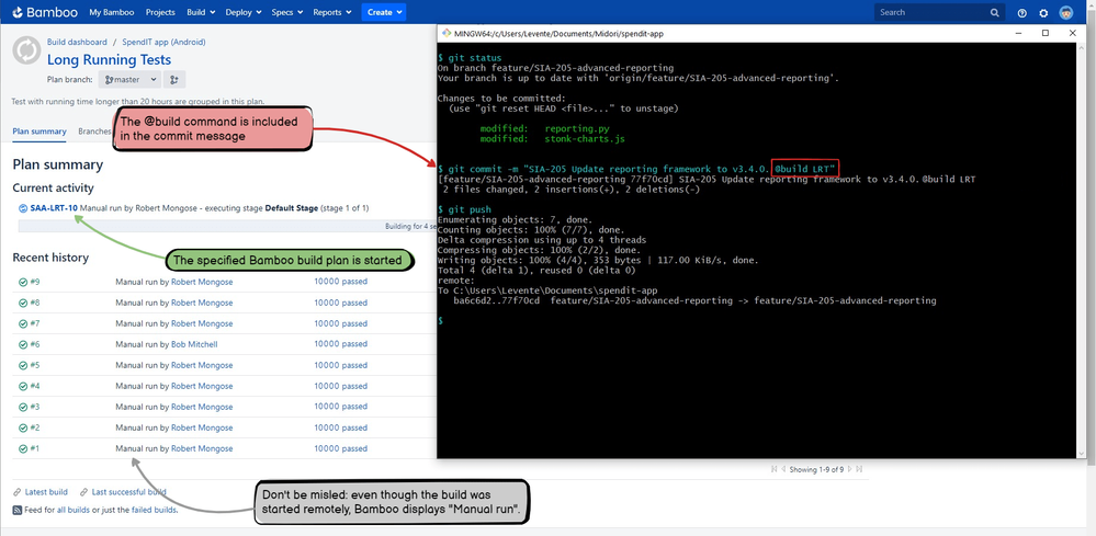

You can implement extremely flexible (conditional, branch-dependent, etc.) Bamboo builds with the Better DevOps Automation app by creating a new automation rule:
  1. Use the Commit Created Trigger to start the rule.
  2. Add a condition that compares the branch name to your desired branch name and continues the rule only if those are equal (or match a regex, etc.). You can access the branch name via the smart value {{devops.commit.branch}} (reference).
  3. Use the Run Groovy Script action with one of the ready-made Groovy scripts which start a Bamboo build.
This approach is highly customizable. Here is an advanced example where the build can be selected from the commit message (it's different from your use case, but demonstrates the flexibility very well):
devops-automation-for-jira-bamboo-build
