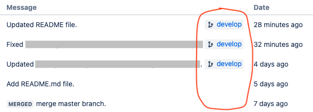

I thought I fixed the problem and made several commit/pushes on develop. Now when I look at my develop commits in Bitbucket, I see a develop branch icon to the right of the message like this.

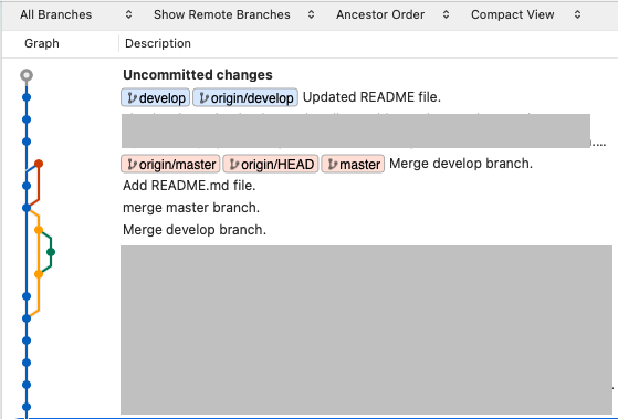

Here's what the History looks like in SourceTree.

The reason why those commits are showing the "develop" branch tag is that those commits are not currently present in the main branch of the repository.
For every commit that is in a branch that was not yet merged to the main branch of a repository, you'll see that tag with the branch name.
The merge from master to develop you executed was successful, as illustrated in the graph by the yellow line meeting the blue line. After that, you pushed additional commits to the develop branch (Updated ..., Fixed..., Updated README file), and those were not yet merged back to the main branch.
This is why they are displayed with the "development" branch tag in the UI. As soon as you merge the develop branch with the main branch again, that tag should disappear.
