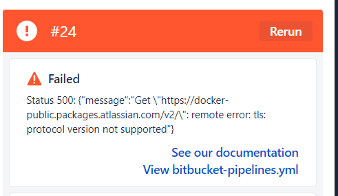

When I run the pipeline it fails with the below error:
[2021-11-19 11:58:12,612] An error occurred whilst pulling image.
com.github.dockerjava.api.exception.InternalServerErrorException: Status 500: {"message":"Get \"https://docker-public.packages.atlassian.com/v2/\": remote error: tls: protocol version not supported"}

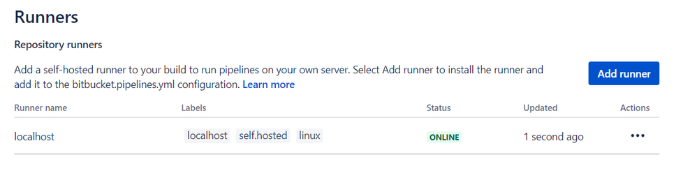

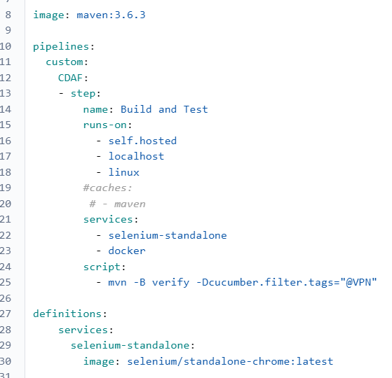

I have added a screenshot of the pipeline yaml file as well.PipelineYAML.PNGRunner.PNG

Hi @farkhnawaz
G'day!
Looking at the error, I believe your server using an outdated TLS and cipher hence you getting the error "remote error: tls: protocol version not supported".
You can use the following commands to check your OpenSSL version
openssl version
If you are using v1.1 then you need to upgrade your server OpenSSL version to at least v1.2 or v1.3. Upgrade will depend on your Linux distros and a quick search should give you information on how to upgrade.
Let me know how it goes
