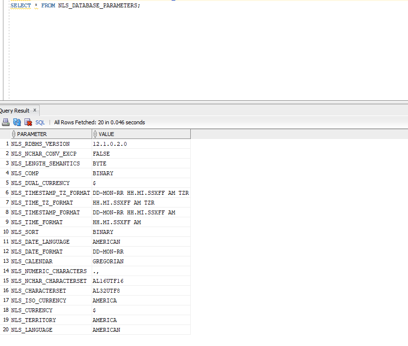

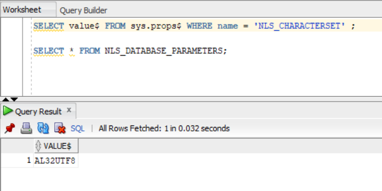

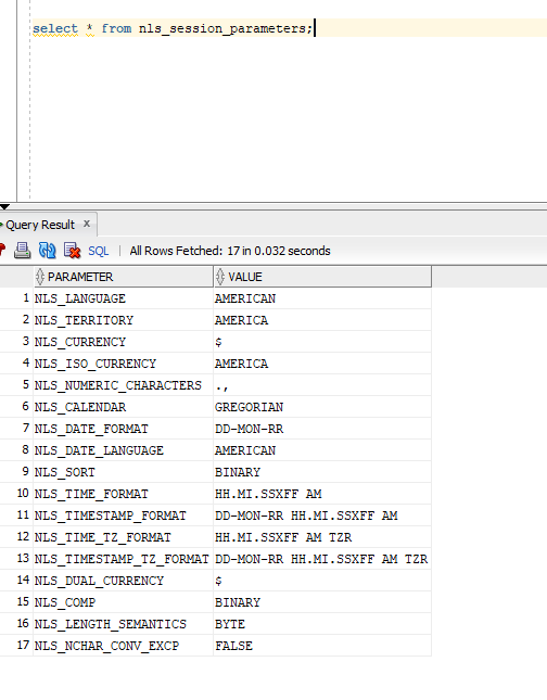

And below are the screenshots of the queries I ran against my database which bitbucket is interacting.
It looks good to me, Let me know if you wanted to change anything and try.

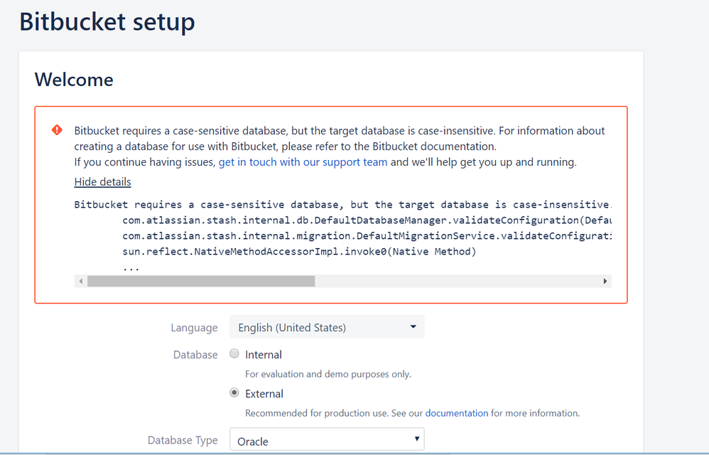

Here is the Full screenshot of the Bitbucket when I attempt to connect to Oracle DB,
And I couldn't Enable debug mode to get logs for the bit bucket. Can you be more clear where or any pictures/video that how to enable the debug mode ?
