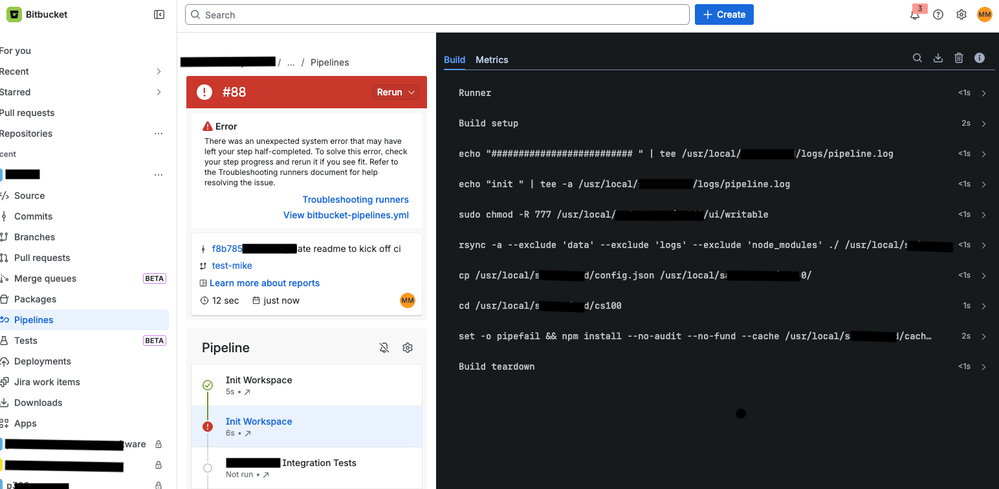

 Getting errors when Bitbucket runs my pipeline:
Error
There was an unexpected system error that may have left your step half-completed. To solve this error, check your step progress and rerun it if you see fit. Refer to the Troubleshooting runners document for help resolving the issue.
In the pipeline build log (see attached, on the right) it shows no failed command, no errors it appears to be some internal pipeline problem.
I choose Rerun failed steps and it will move past that error for 1 or 2 more steps, then show same error again. If I keep choosing Rerun failed steps 4 or 6 times, it keeps making progress and eventually completes.
* To be clear Rerun failed steps is rerunning the same instance, not creating a new pipeline instance.
BTW this pipeline has been running for 6 months without a problem, until today. It ran several times yesterday without a problem.
Any ideas appreciated.
