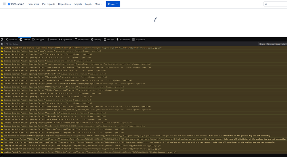

I've never had this problem before, but since yesterday my bitbucket webpages stopped loading:
No one else seems to have this problem and it's only affecting bitbucket. Jira and confluence works as normal.

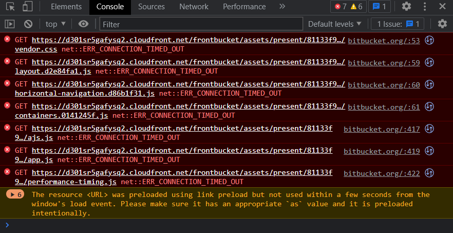

I've tried both the incognito tab and a new browser (firefox) but it results with the same problem:
I've also tried to log out on all my devices and restart the computer but nothings works. Does anyone have any idea on what could be the problem?

If the issue is reproducible in both incognito windows and on a new browser, I believe it could be related to your network.
To narrow down the issue further, I suggest using an external network with or without a VPN, as well as mobile hotspots, to see if the problem persists. The issue is likely with your local network if it does not occur on these external networks.

My issue was resolved when I changed to googles DNS. First time I've experienced this problem.
