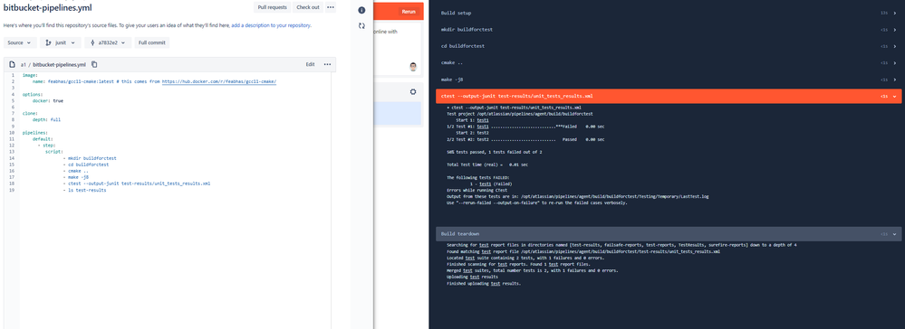

This is interesting, please see my Pipelines configuration and the "Build Teardown" section, once the build has finished, it found the test result:
Can you try to compare your bitbucket-pipelines.yml file and my bitbucket-pipelines.yml file and let me know if there's any difference between those builds?
I'm looking forward to hear from you Francisco.
