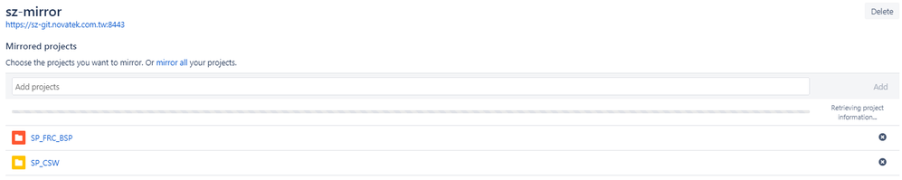

We encounter a strange error as following.
2019-03-05 14:05:37,807 DEBUG [https-jsse-nio-8443-exec-2] @1G0WR5Zx845x6467051x9 172.20.13.211 "GET /mvc/error401 HTTP/1.1" c.a.s.i.web.ErrorPageController User is not authorized to access [/rest/mirroring/latest/repos/610]
2019-03-05 14:05:53,157 DEBUG [https-jsse-nio-8443-exec-7] @1G0WR5Zx845x6467149x6 172.20.13.211 "GET /mvc/error401 HTTP/1.1" c.a.b.i.c.s.CrowdSsoAuthenticationHandler Skipping Crowd SSO as it is not enabled
2019-03-05 14:05:53,158 DEBUG [https-jsse-nio-8443-exec-7] @1G0WR5Zx845x6467149x6 172.20.13.211 "GET /mvc/error401 HTTP/1.1" c.a.s.i.i18n.PluginI18nService No values found in any valid locale for key ProviderManager.providerNotFound and locales [en_US, en]
2019-03-05 14:05:53,158 DEBUG [https-jsse-nio-8443-exec-7] @1G0WR5Zx845x6467149x6 172.20.13.211 "GET /mvc/error401 HTTP/1.1" c.a.s.i.web.ErrorPageController User is not authorized to access [/rest/mirroring/latest/analyticsSettings]
2019-03-05 14:06:53,707 DEBUG [https-jsse-nio-8443-exec-10] @1G0WR5Zx846x6467248x8 172.20.13.211 "GET /mvc/error401 HTTP/1.1" c.a.b.i.c.s.CrowdSsoAuthenticationHandler Skipping Crowd SSO as it is not enabled
We close mirror server for about two months,after reboot the machine we select project to sync,but it show the error message ,could you please help us to solve it?
Our mirror server ip is 172.20.13.211
The screen show Retrieving project information,but we can't see server is retrieving project
Thank you
