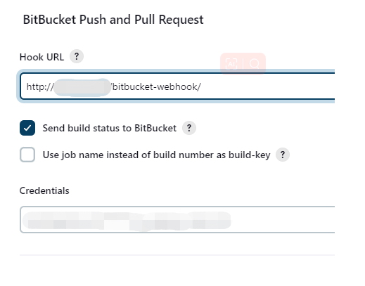

Then I installed "Bitbucket Push and Pull Request" plugin on my Jenkins, and configure the info as below:
The plugin URL: https://plugins.jenkins.io/bitbucket-push-and-pull-request
The global configure in jenkins: (Path: Manage Jenkins --> configure system)

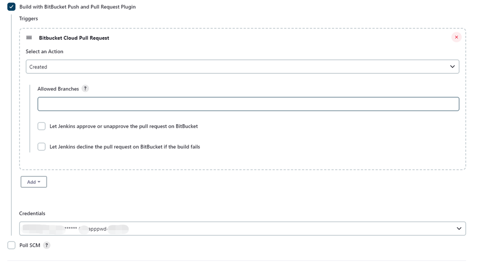

The configuration in jenkins job: (Credentials used username and app password with bitbucket)
