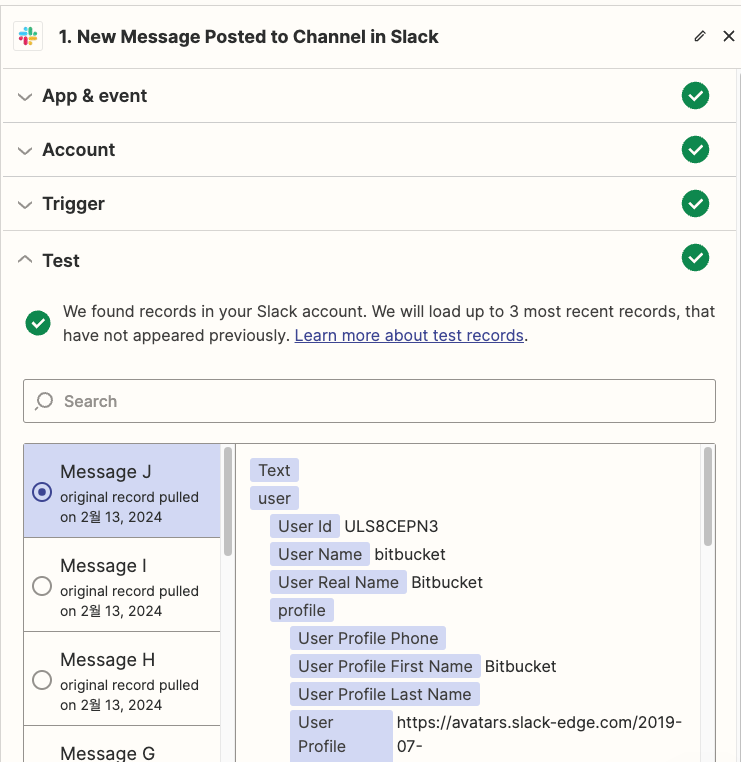

Seems like I am having the same problem.
I am trying to use zapier to filter new messages from Bitbucket Slack Bot but can't because the `Text` field is arrived empty.
Messages from jirabot are working fine. Their `Text` fields are filled with texts.
please share your thoughts on this. @p2paul
