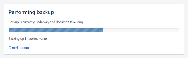

Sometimes my Bitbucket backup gets stuck showing the progress bar. The actual backup seems to be completed but the progress bar doesn't move. Any suggestion? Thanks.

Thanks for helping. We have a starter license so I guess we don't qualify for tech support. Backup is done every night and completes almost every time, in several months it got stuck twice. This is for Bitbucket Server. We have log that we could definitely share.

When it gets stuck it never completes, or more precisely, the progress bar never completes, but we think the actual backup does complete. In these cases we need to force a stop manually.

In the logs of the backup process, the only difference with an instance where everything runs fine is the presence of the following lines:
[bitbucket.diy-backup.sh:0 -> main][Ubuntu-1604-xenial-64-nextcloud] INFO: Backing up the database and filesystem in parallel file has vanished: "/var/atlassian/application-data/bitbucket/log/audit/atlassian-bitbucket-audit-2019-02-12.0.log9085978665663793.tmp" rsync warning: some files vanished before they could be transferred (code 24) at main.c(1183) [sender=3.1.1] /var/atlassian/application-data/bitbucket/backupscript/atlassian-bitbucket-diy-backup/common.sh: line 293: bitbucket_unlock: command not found
