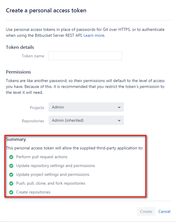

SASIDHAR.KANKIPATI
May 6, 2020
Hi All,
I have encountered the same issue, Is there any solution yet?
The create project option is not shown while creating personal access token. That could be the reason its not allowing to create project using token though the user has sufficient permissions to create project.
Like Christopher Atkins likes this

Theodore McLean
July 8, 2020
Hi folks,
My team stumbled on the same issue. I opened a support ticket with Atlassian, and support told me that it is not possible to create a project with a Personal Access Token.
They linked me to the docs for Personal Access tokens and pointed out that they do not explicitly say that Project Admin tokens can create Projects. Sasidhar's screenshot of the token creation screen shows the same thing.
I suggested they make the documentation a bit clearer since several folks have stumbled on this and creating a Project with a Personal Access Token seems like it should be a feature.
I hope this helps.
