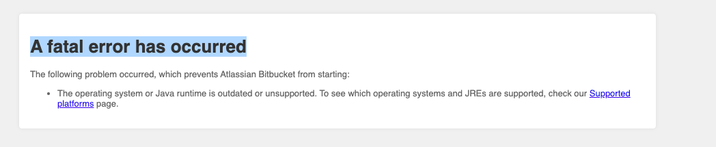

I have ensured that the set-jre-home.sh script is setting the correct version, and it's pointing at this version, but the UI is displaying this page:
I think this is a bit misleading though, because seem as though the java is fine. I'm on RHEL Linux, but the Supported platforms page doesn't list specific Linux Distributions as supported or not, and the previous version ran fine on this server.
