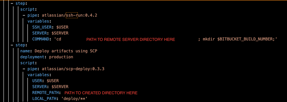

A few months back, I created a pipeline to deploy files from bitbucket to a remote server (Dreamhost). It was working up until Dreamhost automatically changed our server name and address. I thought it would just be a matter of reconfiguring ssh keys, but I've been troubleshooting for days and can't seem to figure out what the solution is.
In my pipeline, I'm able to run the ssh-run pipe just fine and am able to create an empty directory on the remote Dreamhost server (which makes me think this isn't an ssh issue?). However, the next step uses scp-deploy to try to ADD files to that newly created directory (which exists), and the pipeline fails there.
Has anyone else had trouble with scp-deploy and/or does anyone have an alternative way to deploy files to a remote server in pipelines?
Here are the two steps I'm referring to (with sensitive information removed):
And the error I get is: "Host key verification failed."

The error message "Host key verification failed." doesn't have anything to do with the SSH keys you set up to connect to your server. When connecting to a server over SSH, one of the first things that SSH will do is to verify if the server's fingerprint matches with any entry on the local known_hosts file (in this case in Pipelines's known hosts), unless the flag StrictHostKeyChecking=no is used.
The pipe ssh-run uses this flag, which is why it is able to connect to your server. However, the pipe scp-deploy does not use this flag and, since your server's fingerprint has not been added to the Known Hosts (from Repository settings), it fails.
You mentioned that you are unable to fetch the fingerprint of the remote host in the 'SSH KEYS' section of the Repository settings. What error do you get when you try to do that? Please keep in mind that if you use a custom port for SSH, you need to specify that as well when fetching the fingerprint.

When I'm unable to fetch the fingerprint, all the error message says is: "Unable to fetch fingerprints, check host SSH connection and try again". I've tried using the Dreamhost hostname, ip address, and the ip address with the port on the end as well, but sadly no luck with any of those.
I also just tried adding " EXTRA_ARGS: ['StrictHostKeyChecking=no']" to the scp-deploy pipe but I still get the same error message as before. Shouldn't scp-deploy work with that flag if ssh-run is working?

Instead of disabling StrictHostKeyChecking, I would suggest the following:
Add in the script of your bitbucket-pipelines.yml file the following command before the scp-deploy pipe:
- ssh-keyscan your.domain >> ~/.ssh/known_hosts
where your.domain replace with the domain name of your server. Since the ssh-run pipe can connect to your server from the build, this command should be successful and it should add the fingerprint of your server in the known_hosts file of the Pipelines build. Then, the scp-deploy pipe should work.
I believe the EXTRA_ARGS variable should be
EXTRA_ARGS: ['-o', 'StrictHostKeyChecking=no']
However, I would not recommend doing that.
You can also create a ticket with the support team to look into why the fingerprint cannot be fetched from the website, when the Pipelines build can access your server via SSH. If you want to create the ticket yourself you can create it via https://support.atlassian.com/contact/#/, in "What can we help you with?" select "Technical issues and bugs" and then Bitbucket Cloud as product. Otherwise, let me know and I can create the ticket for you.
