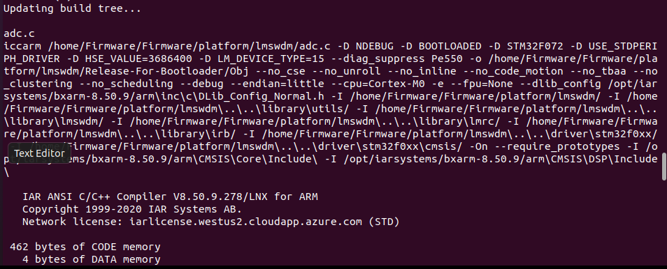

See the output from bitbucket pipeline.  It almost seems like the command is missing a return key or is waiting on something to continue. I've uploaded a screenshot of what happens when I run the same command on my local docker container.
iarbuild Firmware/platform/lmswdm/lmsw105.ewp -build "Release-For-Bootloader" -log all
IAR Command Line Build Utility V8.4.11.7092/LNX
Copyright 2002-2020 IAR Systems AB.
Building configuration: lmsw105 - Release-For-Bootloader
Updating build tree...
0 file(s) deleted.
adc.c
iccarm /opt/atlassian/pipelines/agent/build/Firmware/platform/lmswdm/adc.c -D NDEBUG -D BOOTLOADED -D STM32F072 -D USE_STDPERIPH_DRIVER -D HSE_VALUE=3686400 -D LM_DEVICE_TYPE=15 --diag_suppress Pe550 -o /opt/atlassian/pipelines/agent/build/Firmware/platform/lmswdm/Release-For-Bootloader/Obj --no_cse --no_unroll --no_inline --no_code_motion --no_tbaa --no_clustering --no_scheduling --debug --endian=little --cpu=Cortex-M0 -e --fpu=None --dlib_config /opt/iarsystems/bxarm-8.50.9/arm\inc\c\DLib_Config_Normal.h -I /opt/atlassian/pipelines/agent/build/Firmware/platform/lmswdm/ -I /opt/atlassian/pipelines/agent/build/Firmware/platform/lmswdm\..\..\library\utils/ -I /opt/atlassian/pipelines/agent/build/Firmware/platform/lmswdm\..\..\library\lmswdm/ -I /opt/atlassian/pipelines/agent/build/Firmware/platform/lmswdm\..\..\library\lmrc/ -I /opt/atlassian/pipelines/agent/build/Firmware/platform/lmswdm\..\..\library\irb/ -I /opt/atlassian/pipelines/agent/build/Firmware/platform/lmswdm\..\..\driver\stm32f0xx/ -I /opt/atlassian/pipelines/agent/build/Firmware/platform/lmswdm\..\..\driver\stm32f0xx\cmsis/ -On --require_prototypes -I /opt/iarsystems/bxarm-8.50.9/arm\CMSIS\Core\Include\ -I /opt/iarsystems/bxarm-8.50.9/arm\CMSIS\DSP\Include\
