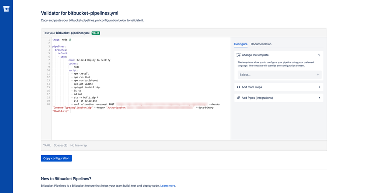

Content of bitbucket-pipelines.yml
Note: The code below is valid & have checked it here

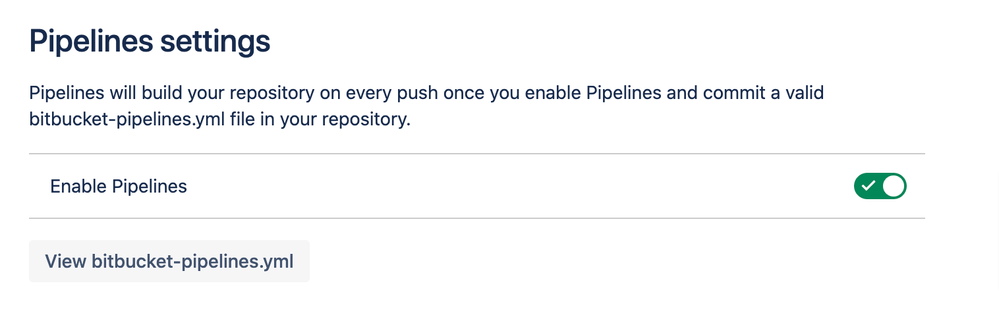

I've pipelines enabled as well, you can check that here:

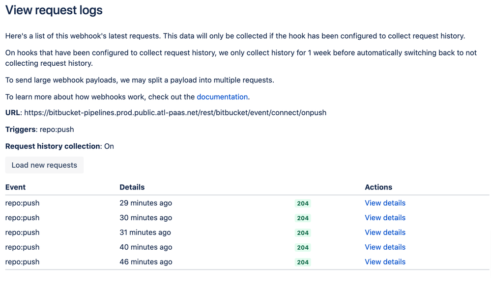

Also here are the request logs for the PUSH trigger of bitbucket.
